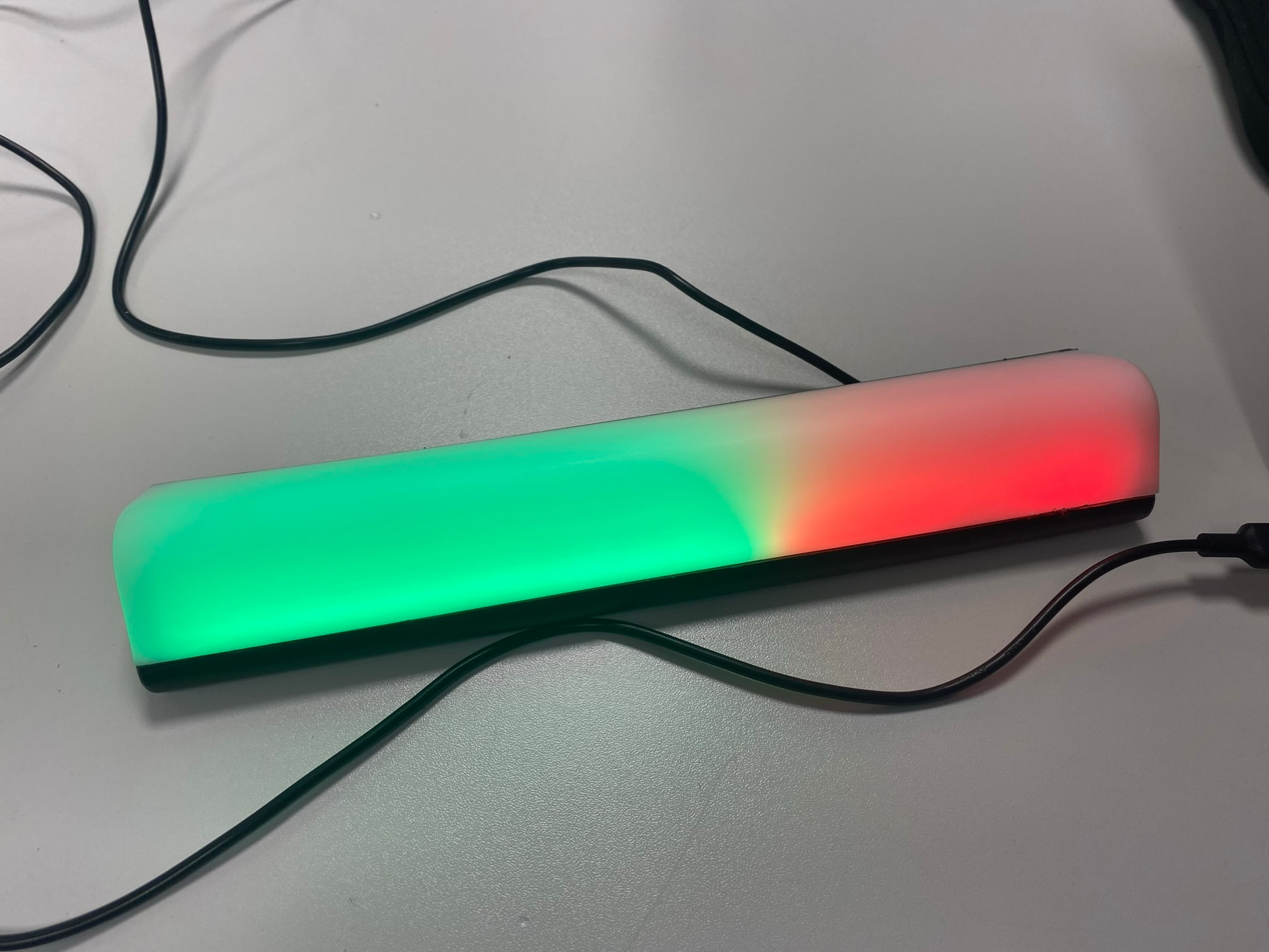

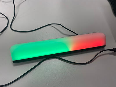

This is the IKEA SKAFTSARV being re-used as an improvised n-teller, driven by python from a separate laptop.
This is one we hacked so it runs WLED, and then elder child is programming in python so his laptop grabs the mqtt feed of the population of the revspace then drives the WLED to show how many people are here (up to 15 - there are only 30 LEDs).
This is also why I keep on temporarily logging in and out guests named test1234 and testmqtt1234…

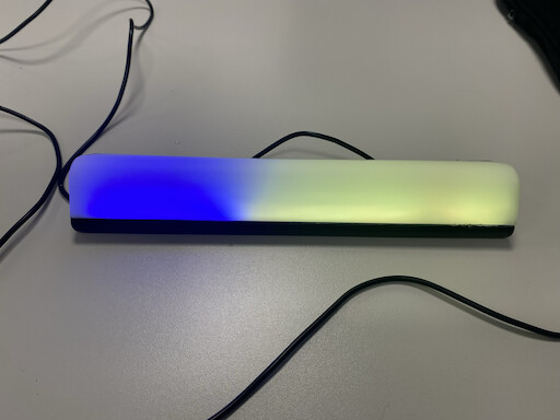

This probably deserves a project page… but the developments are getting ahead of documentation.
Eldest child has rewritten their python script to grab the data from @bertrik JSON presentation and then push it to the WLED. Currently it will do this when they run the script.

So some form of progress. In the meantime we are going to plug the older child’s python into a launchd job on a 15 minute cycle and let it drive plugged in WLED-modded lights in the house. Still using the JSON from @bertrik’s server.
